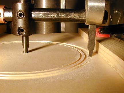

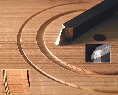

I've used a fly cutter with bits I ground myself. Shown are two bits I ground for the dimensions of a specific rosette.

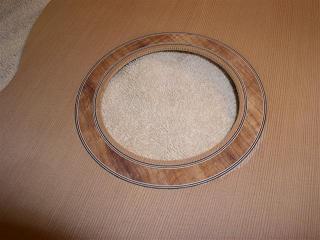

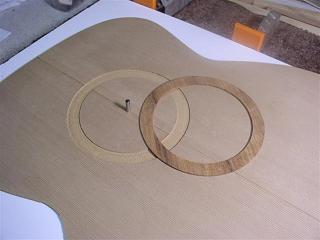

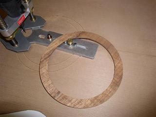

I use a modified Stew Mac circle cutter. As designed by Stew-Mac the
cutter works great but a Dremel is just way too underpowered for me. So,
I took their fixture and cut off the dremel base, welded a new aluminum
base in its' place and sized it to use with my laminate trimmer. Now I
have a Stew-Mac base which I use with (presently) my Porter Cable 310.
Plenty of power and precision. You can see it at http://
www.wellsguitars.com/In_The_Shop/Mediterranean_Quilt/
Mediterrainean_Quilt.html.
Sylvan
http://www.wellsguitars.com

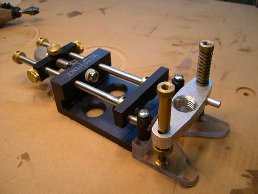

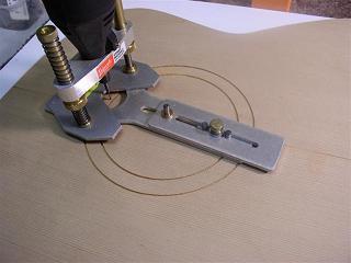

Here's what I'm using:
It's essentially the Stew-Mac dremel piece on a Micro-Fence base, it allows me to make channels with absolute control. The Stew-Mac circle cutter base is a bump adjust system, this is precise down to thousands of an inch. Very very useful, like Alan fly cutters scare me a bit and they are not very precise and your locked into the size of your cutter, I really feel this is the best solution that I've seen so far.
I have some info on my site here about it:
Rosette Article
-Paul-
-Paul-

PostPosted: Wed Feb 16, 2005 2:08 pm
Paul that tool makes me drool.
I too use the Stewmac, and some home made setups using a dremel grout removal base cut perpendicular then epoxied into a 1/4 inch tempered hardboard base. After getting the Dremel attached then I determine my distance and drill pivot holes, three for a D28 rosette, I then go back with a dremel and a quarter inch cutter in the middle hole, that gives me all three rings. But Paul's has exactly what I found to be a drawback on the Stewmac tool, fine radii adjustment, the vertical adjustment is great.Dickey38399.9879050926
PostPosted: Wed Feb 16, 2005 3:12 pm
Paul---that's beautiful. And I bet it works, as an added bonus.
PostPosted: Wed Feb 16, 2005 5:14 pm
Posts: 886
Oh man does it ever work Steve, I did a bonehead move on a rosette and sanded through some of the inlay when I was sanding the top...
So I whipped this puppy out and cut out the inlay and trim and dropped new stuff in, I was actually shaving the trim out. I could have never done that with the Stew-Mac setup, I can also test fit and never go to far anymore, it's the one of the best tools in my shop
